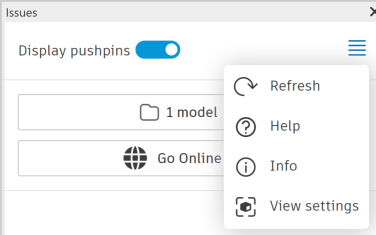

Settings
View settings for the Revit Issues Add-in view can be found in the hamburger menu on the Issues pane.
Within the view settings you can check the current name view used by the Revit Issues Add-in. This is useful if the name of the view has been changed from default.
The View options allow the user to control how the Revit Issues Add-in view is used:
- When Default view is selected, the add-in will first try to find the correct view within the opened file on which to display the selected issue. If the view cannot be found within the file then the add-in will revert back to the Revit Issues Add-in view and show the issue there.
- When Revit Issues Add-in view is selected, the add-in will use the Revit Issues Add-in view when any issue is selected, regardless of whether the file contains an appropriate view or not.
