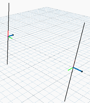

Framing Element Axis
Each Revit structural family has its axes defined. These axes are family-specific, the common thing being that the X axis is always along the length of the framing element.

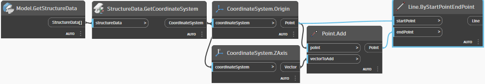

Note: A simple way to correctly identify the framing element's axis is to use the StructureData.GetCoordinateSystem node, that gives a CoordinateSystem object in Dynamo. Then, you can display the axis of interest (the Z axis, for example) by creating a line (Line.ByStartPointEndPoint) from the axis origin (CoordinateSystem.Origin) to the Z axis vector end (CoordinateSystem.ZAxis, Point.Add to the Origin):

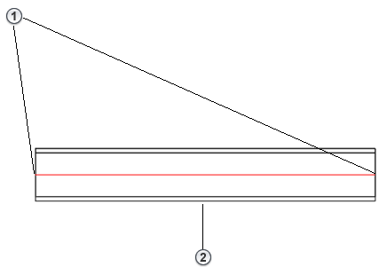

Zones
A single framing element (beam or column) has two ends, and a body between the two ends. Both the body and the ends are called zones. Zones are identified by the grouping mechanism.
- Beam ends
- Beam body

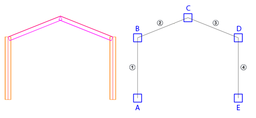

Grouping Mechanism
For a given model, a grouping algorithm is used to identify locations where connection nodes could be placed.
- Column B1
- Beam B2
- Beam B3
- Column B4
A - Node A: Column B1 - End
B - Node B: Column B1 - End; Beam B2 - End
C - Node C: Beam B2 - End; Beam B3 - End
D - Node D: Beam B3 - End; Column B4 - End
E - Node E: Column B4 - End
