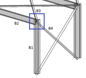

The connection node marked in the following image is a connection node of four elements. Place the Knee of frame, bolted, with haunch between B1 and B2, with B1 as the main element and B2 as the secondary element.
Note that:
- The slope angle for B2 is 11 degrees.
- B1 is vertical.
- The web of B1 is parallel to the web of B2.
- B1 and B2 meet end-to-end.
- The webs of B1 and B2 are parallel.
- B2 has a W Shapes family and a W12X26 type.
