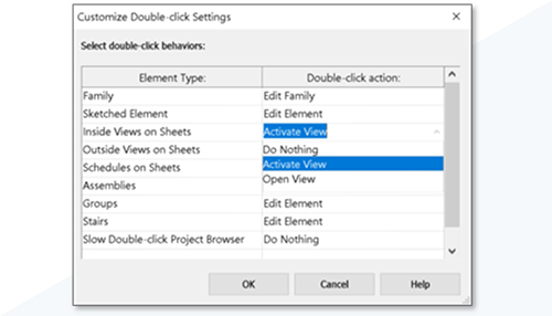

The Customize Double-click Settings dialog in Options has been adjusted.
- Views and Schedules have been split into dedicated options, with no change to the default action:
- Inside Views on Sheets
- Outside Views on Sheets
- Schedules on Sheets
- Inside Views on Sheets has a supplementary option to Open View, besides Activate View and Do Nothing.
- Slow Double-click Project Browser element has been added, connected to the Revit.ini option DoubleClickProjectBrowser. The default is Rename, with the option of Do Nothing.
