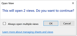

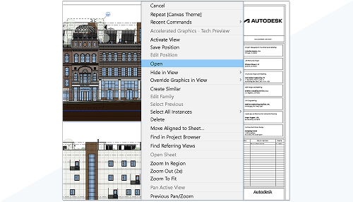

You can now open one or more placed views directly from a sheet. Select the desired view or views, right-click, then select Open from the contextual list.
This functionality is similar to the Project Browser Open command. If you select multiple views from the sheets, the same dialog opens to confirm your choice.
