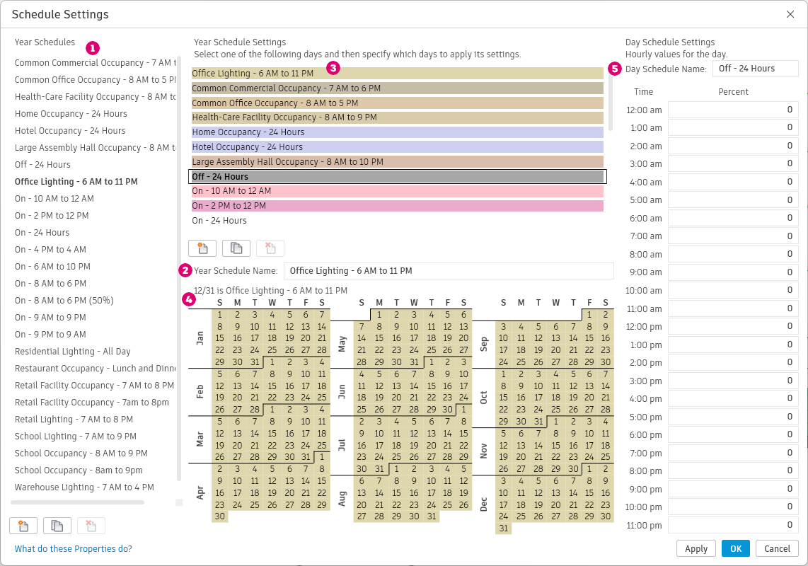

Select a schedule
- In the Building/Space Type Settings dialog, click the value field for a schedule (Occupancy, Lighting, and Power Schedule), and click
- In the left panel of the Schedule Settings dialog
, select a default schedule and click Ok.
Add a Year Schedule
- In the left panel of the Schedule Settings dialog, click
- Enter a name in the Year Schedule Name field
- A default day schedule will be applied to all days.
- Select a day schedule from the list
and then select the days in the calendar
to apply the selected day schedule.
Note: Each day of the year can have different day schedules applied.
Add a Day Schedule
- In the center panel of the Schedule Settings dialog, click
- Enter a name in the Day Schedule Name field
- In the right panel, enter the value for Factors (0%-100%) for each hour.
Copy a schedule
- In the year or day schedule list, select a schedule to copy.
The new schedule is assigned the name of the schedule that was copied with a number appended, and added to the list.
- Click
The new schedule is assigned the name of the schedule that was copied with a number appended.
- (Optional) Rename the schedule in the name appropriate field,
or
- Make adjustments to the days (year schedules), or hourly Factor values (day schedule).
Rename a schedule
- In the year or day schedule list, select a schedule to rename.
- Rename the schedule in the name appropriate field,
or
Adjust an existing schedule
- In the year or day schedule list, select a schedule to adjust.
Delete a schedule
- In the year or day schedule list, select a schedule to delete.
- Click
Note: Only schedules which are not used may be deleted.
