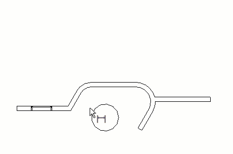

  1. Click Annotate tabDimension panel (Diameter).
  2. Place the cursor on the curve of a circle or arc, and click.
    A temporary dimension displays.
    Tip: You can switch the reference point for the dimension between a wall face and a wall centerline by pressing Tab.
  3. Move the cursor along the dimension line, and click to place the permanent dimension.
    By default, a diameter prefix symbol displays in the dimension value.
