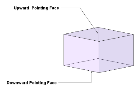

    • Do not select upward-pointing and downward-pointing faces for the same toposolid.
    • To make toposolids that cover both upward and downward faces, split the mass into 2 faces, so that each face is either completely upward or downward. Then create one or more toposolids from the downward faces and one or more from the upward faces.
