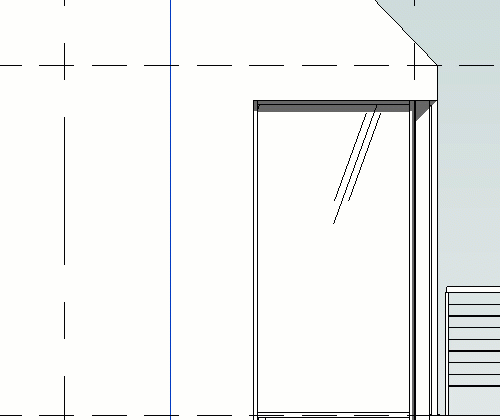

- Place the cursor on the element face to highlight it. You may need to press Tab to select the desired face.
- Click to select the face.
Sketch the face area to split.
Note: The sketch must be in a closed loop inside the face or an open loop that ends on the boundary of the face.
