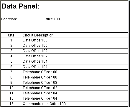

Data panel
  • This type of template can only be used with a data panel device. The primary purpose of a data panel is to identify circuits and data outlets and associate them with telephone numbers. Data panels can be connected to anything except power devices. Typical devices connected to a data panel include telephones, fire alarms, and security devices. Data panels display a single circuit column.
    Data panel schedule with one circuit column
