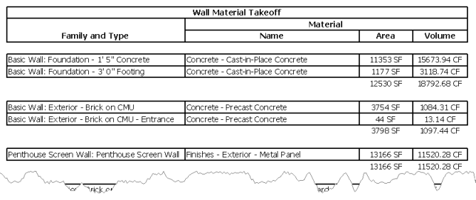

Material Takeoff Schedules
Show more detail about the assembly of a component with lists of sub-components or materials.
Video: Create a Material Takeoff Schedule
Material takeoff schedules list the sub-components or materials of any Revit family. Material takeoff schedules have all the functionality and characteristics of other schedule views, but they allow you to show more detail about the assembly of a component. Any material that is placed in a component within Revit can be scheduled.
Note: When Revit computes the volume of materials for individual layers within a wall, some approximations are made to maintain performance. Minor discrepancies might appear between the volumes visible in the model and those shown in the material takeoff schedule. These discrepancies tend to occur when you add a sweep or a reveal to a wall, or under certain join conditions.
