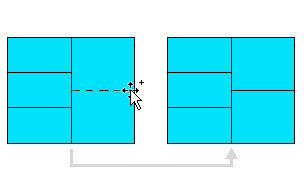

After creating a curtain wall, use grids to divide the wall into panels.
- Architecture tab
Build panel
(Curtain Grid) - Modify | Curtain Wall Grids tab
Curtain Grid panel
(Add/Remove Segments)
You can customize the curtain grid, place mullions on grid lines, and embed doors and walls within curtain panels.
