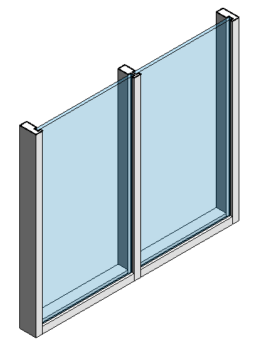

Use the grid on a curtain wall to place mullions.
- Architecture tab
Build panel
(Mullion)
When you add mullions to a grid, the mullions resize to fit the grid. If you add a mullion to an inside grid, the mullion is centered on the grid. If you add a mullion to a perimeter grid, the mullion aligns so its border is flush with the outside of the wall.
