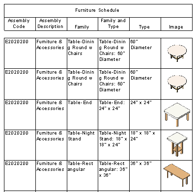

Images that you can associate with an element include images you import into the model and images that you create by saving views of the model (such as 3D or rendering views) to the project. If included in the schedule definition, the images display in the schedule viewport that is placed on a sheet. The schedule view itself includes the image name, but not the image. The following example shows a furniture schedule with images on a sheet view.
