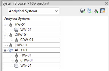

The System Browser displays the hierarchy of system zones and the analytical systems (water loops, air systems, and zone equipment.)

The tree in the System Browser displays the hierarchy of system zones and the analytical systems (water loops, air systems, and zone equipment.) The water loops and air systems are shown at the top level with their associated water loops and zone equipment shown below.
If an element has not yet been fully defined, a warning icon
displays in the System Browser.
