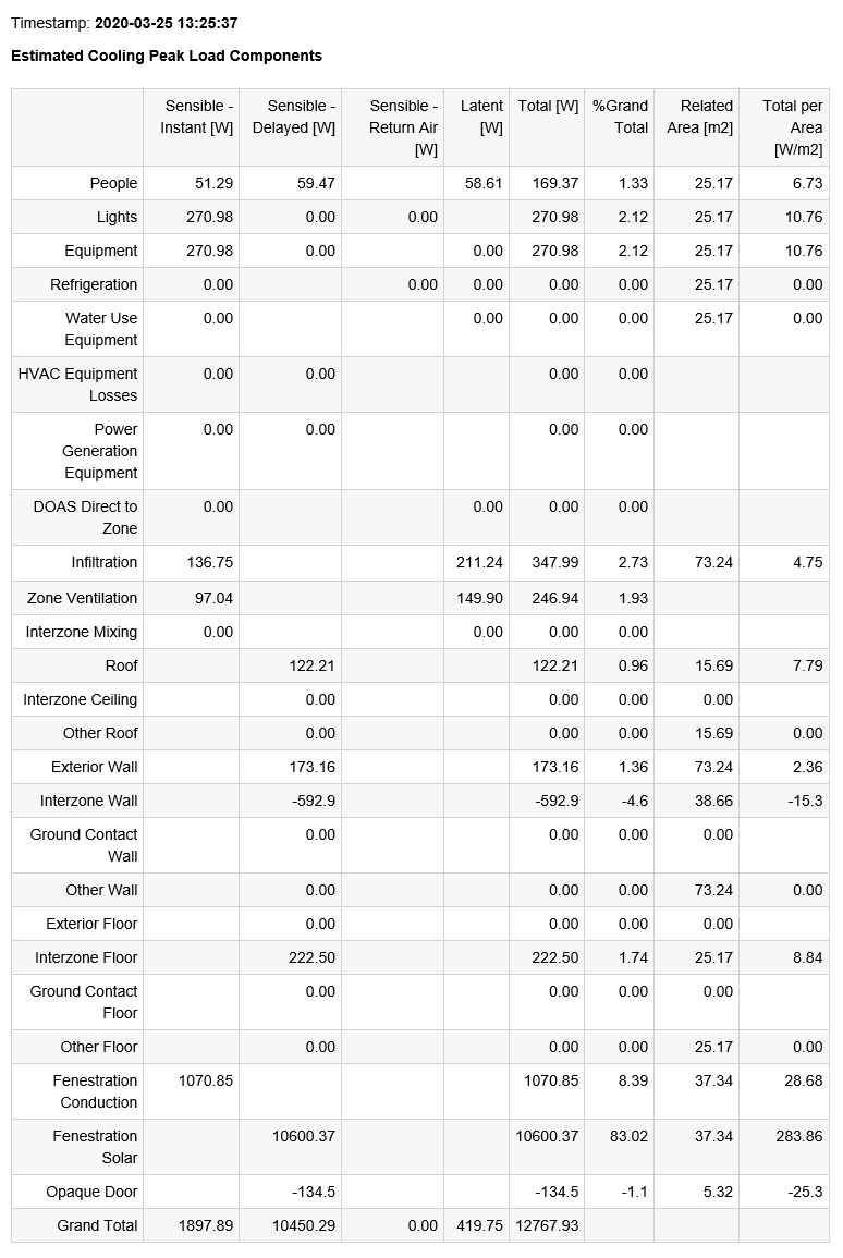

For example, the Zone Component Loads Summary contains heating and cooling sizing information for each analytical space. An example of a peak cooling load for a space is shown below. In this example, the total load is 12768W.
