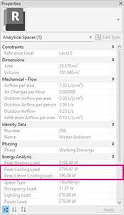

Review Results on the Analytical Model
In addition to the report which is generated after an analysis, the heating, cooling, and air flow peak demands are also set as properties on each analytical space. The following example shows the same cooling load as highlighted in the report section above.
Note: Peak load demands can be scheduled for a summary of the load demands from the analytical spaces.
