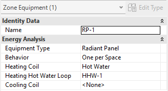

Zone equipment that includes coils, such as a Radiant Panel, doesn't have one or more coils assigned.
The systems analysis will fail and a message similar to the following will display at the bottom of the eplusout.err file:
**Severe** <root>[Coil:Cooling:Water][RP-1-1 Cooling Coil] - Missing required property 'water_inlet_node_name'.
**Severe** <root>[Coil:Cooling:Water][RP-1-1 Cooling Coil] - Missing required property 'water_outlet_node_name'.
**Fatal** Errors occurred on processing input file. Preceding condition(s) cause termination.
In the Properties palette, specify a Cooling Coil and re-run the systems analysis.
