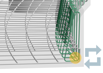

You can toggle the stirrup orientation for the aligned distribution free form rebar by pressing the Space bar.
This applies only for the closed stirrups in the set.
For additional information, see Model Stirrups using Free Form Rebar Aligned Distribution.
