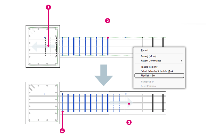

To choose the direction in which a rebar set expands, use the flip option in the right-click menu.
Expansion direction for set.
First bar in Number with Spacing set.
Expansion direction for set after flip.
First bar in Number with Spacing set after flip.
This feature was suggested by customers on the Ideas forum and is described on the product road map.
See Flip Rebar Set Direction.
