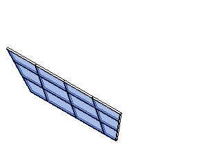

If you right-click a curtain system or sloped glazing and click Select Mullions, the following options are available:
Sloped Mullion Selection Options
On Grid 1. Selects all interior mullions that lie on the grid 1 layout.
On Grid 2. Selects all interior mullions that lie on the grid 2 layout.
Inner Mullions. Selects all interior mullions on the same face as the selected curtain element.
Border Mullions. Selects all border mullions on the same face as the selected curtain element.
Mullions on Host. Selects all mullions on the host.
