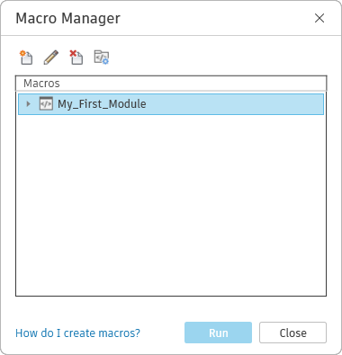

Create a Module
- Click Manage tab
Macros panel
Macro Manager.
- Click
Create Module.
The Create a New Module dialog opens.
- Provide a name for the module.
- Click OK.
The new module is created and listed in the Macros Manager. One or more macros may now be added.

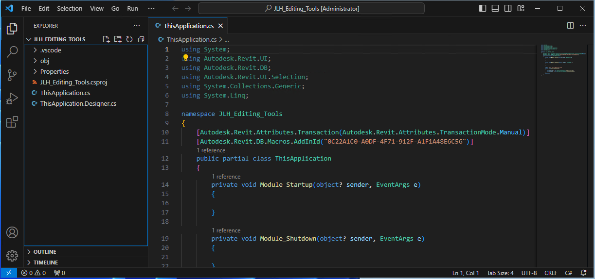

- A session of Visual Studio Code is opened where you can begin editing macros.
Edit or Delete Macros
To modify a module (the macros it contains), select it, and click
Edit. The module will open in Visual Studio Code, and you can edit it and its associated macros. See
Create Macros for additional information.
Delete Modules
To delete a module, select it, and click
Delete. Deleting the module will permanently remove it and its associated macros.
