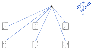

For a structural column example, to show 2 out of the 6 leaders:
