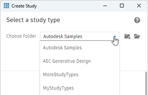

- Store study types in multiple folders, including local folders and mapped network drives.
- In the Create Study dialog, a drop-down list lets you quickly select the folder that contains the target study type.
- Add more folders to the list and rearrange them using a simple interface. Remove folders from the list when they're no longer needed.

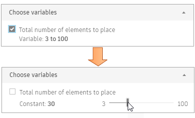

- Change variable inputs to be constant values.

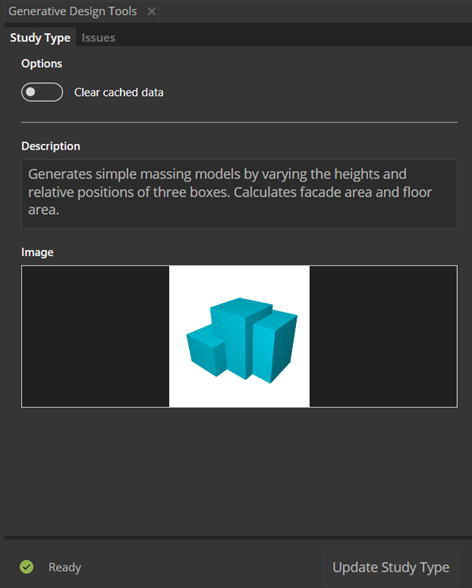

- A new set of tools streamlines and simplifies the creation and update process for study types. To access these tools, click Generative Design
Open Generative Design Tools.
- The tools display in a panel on the right side of the
Dynamo window. Click the Study Type tab to create or update the study type for the current graph, including the associated Dependencies folder.
- When you use Dynamo to open a study type that uses packages that aren't installed locally, a warning message informs you of missing dependencies. Select an option to resolve the issue: install the required packages or custom nodes, or do nothing (so you can resolve the issues manually). This improvement streamlines the process of making sure Dynamo has what it needs to run or edit study types in Dynamo. See Troubleshoot: Missing Dependencies.
- Click the Issues tab to see and resolve issues with the graph. Issue descriptions provide direct links to nodes that require attention, streamlining the troubleshooting process.
