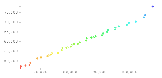

Size and color

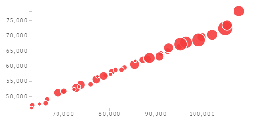

Display additional data in the chart by picking options in the Size and Color drop-downs. By default, all points are the same color and size.
If you pick an option for Size, the points in the graph will display in different sizes. For example, after Box 1 Height is selected for Size, the size of the point represents the height of box 1 in the outcome: Larger point means higher box height, and smaller point means lower box height.
If you pick an option under Color, the points in the graph will display in different colors, from red (low) to blue (high). For example, after Surface Area is selected for Color, the color of the point represents the size of the surface area in the outcome, ranging from red (smallest) to blue (largest).
