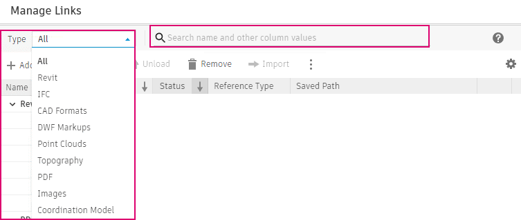

The Manage Links dialog has tabs for Revit models, IFC links, CAD Formats, DWF Markups, Topography, Coordination Moddel, PDF, and Images. Under the tabs are columns that provide information about the link.
Use the filter to show each type, and the Search function to find links.
You can see detailed information of each data type on a collapsible side panel on the right side.

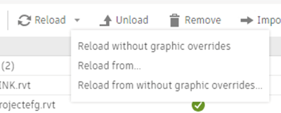

Use the operation tools listed at top for the desired actions (e.g. reload with or without graphic overrides, unload, remove, etc.). They are dynamically generated based on the type and status for the linked file.

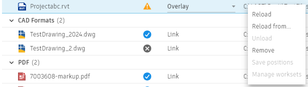

You can also use right click or the More button at the end of each row to access the same operations.

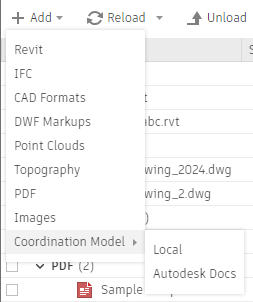

Use the add button to bring referencing data into Revit.
