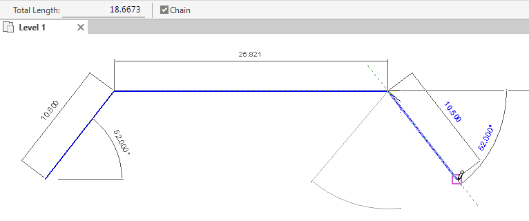

    Measure line with length and angle measurements
    Measure chain with the total length displaying on the Options Bar
