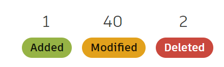

The palette displays an overview of changes, classified in 3 categories: added, modified and deleted objects. An example is shown below:
Changes summary: The palette displays an overview of changes, classified in 3 categories: added, modified and deleted objects. For a quick identification, the added, modified and deleted coordination model objects are highlighted in Revit views. The unchanged coordination objects are greyed out.
  • Added: Objects that were added since the selected version, are represented in the list and highlighted in green.
  • Modified: Objects that were modified since the selected version, are represented in the list and highlighted in orange.
  • Removed: Objects that were removed since the selected version, are represented in the list highlighted in red.
By default all types of changed elements are toggled on. To toggle off Added, Modified, or Deleted, click them. For example, if you want to visualize the Added objects only, click Modified and Deleted. Consequently, the modified and deleted objects will no longer be highlighted on the model.
