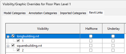

Parameters that control the visibility and graphics of linked Revit models are grouped under their own tab, Revit Links, in the Visibility/Graphics dialog.
This dialog is arranged in a tree structure with the parent nodes referring to separate files (the primary linked model), and the child nodes referring to instances (copies) of the model in the project. Changing the parent node affects all instances, while changing a child node affects only that instance.
The Revit Links tab in the Visibility/Graphics dialog contains the following columns:
  • Visibility: Select the check box to show the linked model in the view, or clear the check box to hide the linked model.
  • Halftone: Select the check box to draw the linked model in halftone. (See Halftone/Underlay.)
  • Underlay: Select the check box to display the linked model as an underlay in the project. The geometry will display in halftone and will not obscure new lines and edges you draw in the project. (To control the line weight and pattern of the underlay geometry, see Halftone/Underlay.)
    Note: Elements in a model set as an underlay are not eligible for tagging. Optionally, in the Visibility/Graphic Overrides dialog, specify the model as "Halftone" instead of "Underlay" to display the model in halftone and allow tagging of model elements.
Visibility for linked Revit models is controlled by view. You can use a view template to save the visibility settings of a particular view and then apply it to other views. See View Templates.
