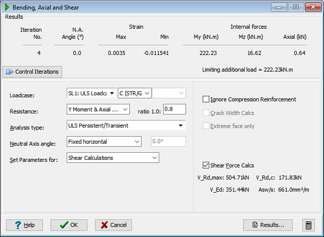

In the example above, the parameters in the first command are equivalent to running the analysis with the settings shown in the following dialog:
