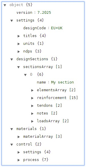

Here is a JSON example, showing the higher-level objects.
It contains 5 main blocks.
settingsThis object contains parameters relating to the Design Code, Titles, Units, and for Eurocodes only, the Nationally Determined Parameters.designSectionsThis object contains parameters relating to one or more Design Sections.designBeamsThis object contains parameters relating to one or more Design Beams.materialsThis object contains parameters relating to the material definitions (concrete, steel, reinforcement, prestress, etc.).controlThis object controls automation and will be discussed below.
The example above defines a single section made up of 2 elements. There is a block which details the reinforcement and tendon location, an optional notes object and an array containing 2 load cases.
