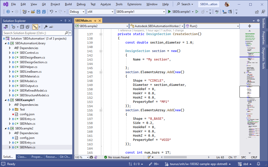

Sample application code utilizing the C# programming language on the .NET platform is provided for automating Structural Bridge Design programmatically.
If you have an interest in becoming even more productive, the sample application provides access to the design section and beam parameters. It also provides an example of modifying these parameters, running analysis, and retrieving key results in a fast and automated way, without the need to open the Autodesk Structural Bridge Design (SBD) application.
