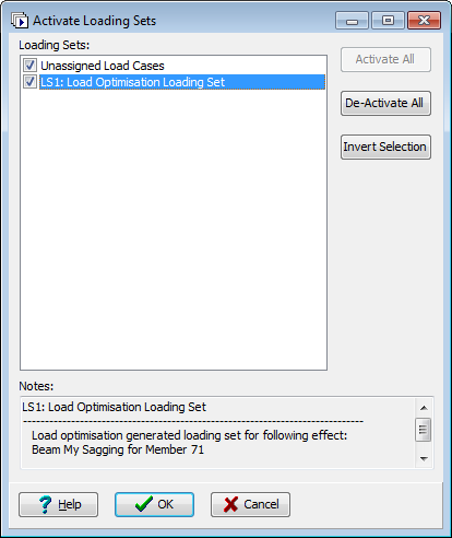

If loading sets have been defined, this form will appear when Calculate | Analyse is selected from the Main Menu. It enables loading sets to be designated as Active or Inactive. Only the Active loading sets are analysed when the OK button is clicked on this form.
Outline Procedure
All the defined loading sets are listed on this form. The load cases that are not assigned to any loading set are treated as an additional loading set. Click with the mouse to check and un-check the box to the left of the loading set name to activate and de-activate it. Note that the Activate All, DeActivate All, and Invert Selection buttons operate on these check boxes. Moving the mouse cursor over the list of loading sets causes the notes for the loading set under the cursor to be displayed in the 'Notes' field at the bottom of the list pane.
