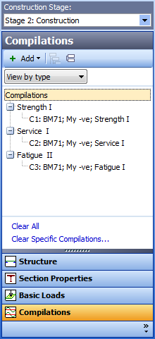

The order of the Compilations in the Active Group Tree List may be toggled between:
- View by reference The compilations are listed in order of their reference number ('C1', 'C2', etc).
- View by type The compilations are listed in order of their compilation type.
On first clicking on a compilation active group item the graphics window initially shows the structure in gray and all the basic loads comprising the compilation in color. On selecting a basic load within the 'Compile Loading Patterns' from the graphics window it shows the currently selected basic load of the current compilation in color with the structure and all other basic loads on the current compilation (only) shown in gray.
Compilations generated automatically by load optimization are identified by having the relevant member, load effect and limit state (where applicable) amended to the compilation reference number. (See 'Related topics' below).
