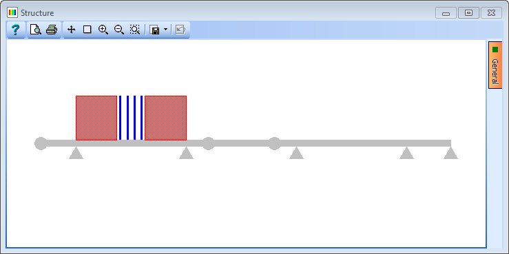

It is required to analyze a five span line beam model as shown below and as defined in example 6.1.
Five Span Line Beam Model
The line beam represents half of a two beam, single track, railway viaduct.

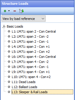

  3. Change the navigation window on the left hand side of the screen to Structure Loads.

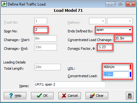

  4. Click on the toolbar + button and select Rail Traffic Load | Load Model 71.
  5. In the Define Rail Traffic Load form change the Ends Defined By: to “span” and Span No: to “2”. Then set Dynamic Factor, Ф: to “1.23”. The intensity of the UDL and concentrated load should be divided by 2 to reflect that only half the load will be applied to one beam. Hence, enter “40kN/m” in the UDL field and “125kN” in the Concentrated Load field (Click OK on the warning messages). Change the Concentrated Load Chainage to “20.5m”.
    Structure
  6. Change the Name: to “LM71 Span 2 – Con central” before closing the form with the ✓ OK button.
  7. In the Navigation window right mouse click on the “L1” load in the list and select Copy from the context menu. This adds a second load case, L2, and opens the Define Rail Traffic Loading data form. Move the concentrated load 2m to the left by changing the Concentrated Load Chainage: from “20.5” to “18.5”. Change the Name: to “LM71 Span 2 – Con -2” before closing the form with the ✓ OK button.
  8. Repeat this for “Con -1”, “Con +1” and “Con +2” changing the concentrated load position and name accordingly.
  9. Repeat 6, 7 and 8 for span 4 (Specify Span No. 6 in the data form as this is the virtual span number due to the drop in span) giving 10 live loads in total. (You may have to re-select Ends Defined By: Span to ensure that the loads are correctly defined). (The concentrated load chainage will be “70.5m” for the central case).

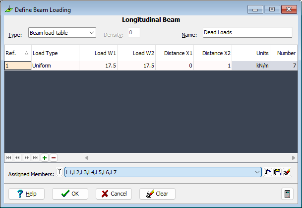

  10. Click on the + button at the top of the navigation window and select Beam Member Load | Longitudinal Beam Load from the selection list.
  11. Click on the Longitudinal Beam Loading form + table button to add a new table row.
  12. In this row set the Load Type to be “Uniform”, Load W1 to be “17.5” (Load W2 is automatically set as it is uniform) and the Name: to “Dead Loads”. To apply this load to the complete beam, box round the whole structure in the graphics window or tick all members in the drop down list at the end of the Assigned Members: field. Close the form with the ✓ OK button.
    Define Beam Loading
  13. Copy the Dead load in the same manner as for the live loads and change the Load W1 value to “11.7kN/m” and the Name: to “Ballast Loads”.
  14. Repeat this again but change the Load W1 value to “2.5” and the name to “Sleeper & Rail Loads”.
    There are now a total of 13 load cases.

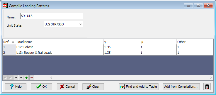

  3. Click on the + button to add a Superimposed Dead Loads compilation. Click on the + button near the bottom of the form twice to add 2 rows to the table. Select “ULS STR/GEO” in the Limit State: drop down. In the first row of the compilation table select the ballast load case and set the gamma factor to 1.35. In the second row select the sleeper & rail load case and set the gamma factor to 1.35. Set the Name: to “SDL ULS”. Close the form with the ✓ OK button.

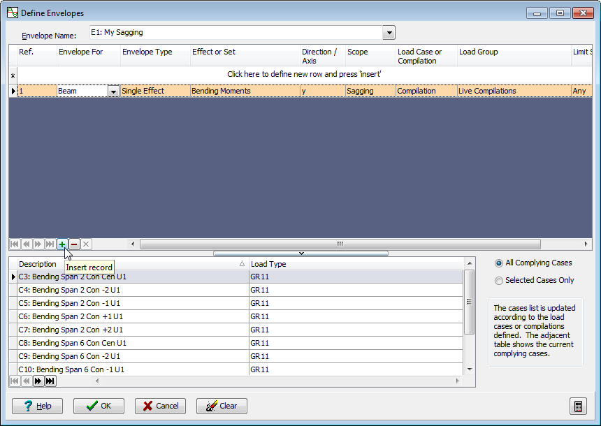

  1. To determine the max bending moment in each of spans 2 and 4 we create an envelope. This is done using the main menu item Calculate | Envelopes to open up the Define Envelopes form.
  2. Click the mouse where it says “Click Here....” and set Envelope For to “Beam”, and accept all other entries as the default values except the Load Group which should be set to “Live Compilations”. Click on the small + button at the bottom of the top part of the table to add this data to the table and because All Complying Cases is selected all live load cases are entered into the envelope automatically. Click on the ✓ OK button to close the Define Envelopes form.
    Define Envelopes
  3. The load cases can now be solved using the main menu item Calculate | Analyse Structure, which carries out the solution and stores results ready for viewing.

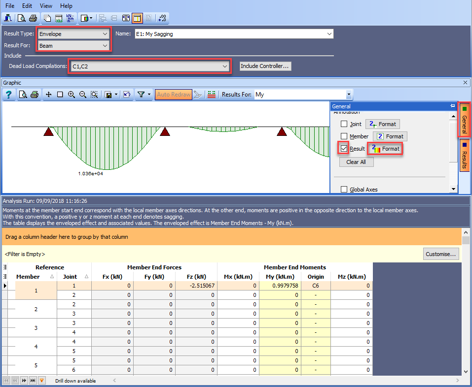

  1. The maximum sagging moments can then be obtained by looking at the results of the envelope in the results viewer. This is opened using the main menu item File | Results
    Results
  2. Set the Results Type: to “Envelope”, the Results For: to “Beam” and the Name to “E1: My Sagging”.
  3. If the graphics and tabular results are not shown on the same screen then ensure that the Graphics is enabled using the menu item View | Set Default Layout | Graphic Above Table.
  4. To add the effect of dead load and superimposed dead load to the enveloped results then use the drop down list in the Include Dead Load Compilations: field to include both Dead &SDL compilations. (This is located near the top left hand corner of the graphics window).
  5. To determine the maximum value then annotate the graphics using the orange “General” button at the right of the graphics screen and tick the Result tick box. If all results are shown then the “Format” button can be used to select maximums only.

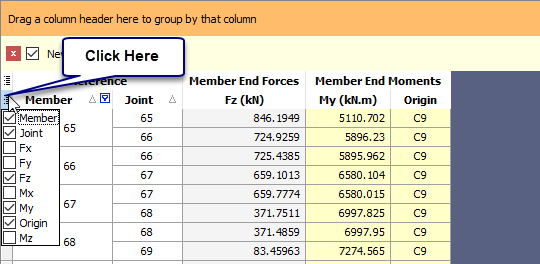

  4. Remove columns in the table that have zero values and have no meaning for a line beam analysis by unticking the selection that appears when clicking on the first column of the headings row - as shown below:
