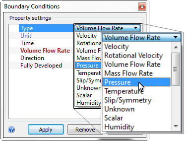

Left click on the return surface.
Click Edit from the Boundary Conditions context panel:
On the Type row, select Pressure.
Leave the Unit as Psi and the Pressure value = 0.
Click Apply.
Note: This defines a static gage pressure of 0 psi, which simulates the outlet to the return duct.
