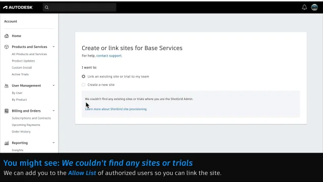

2 - Link your site by activating your subscription in Autodesk
The most important thing to keep in mind when activating your subscription in Autodesk is that you need to have:
- Fully migrated your site and turned off the Flow Production Tracking authentication
- Bought the seats you need on the e-store
Once these two conditions are met, you will be able to link your site to your Autodesk Account.
You may need to wait between 15-45 minutes after turning off Flow Production Tracking authentication before you can link the site, as the information needs to propagate across systems.
See How to link your site for more information.
