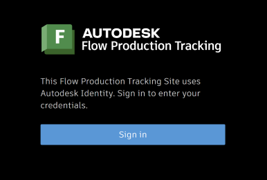

Q. How can I tell if Authentication has been turned off?
An easy way to tell if Flow Production Tracking Authentication has been turned off is by looking at your Flow Production Tracking login page, where it will note that This Flow Production Tracking Site uses Autodesk Identity. Sign in to enter your credentials.

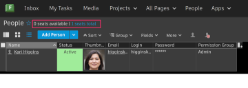

Q. How can I tell if my site has been linked properly?
There are a couple of ways for Administrators to see when their Flow Production Tracking sites have been linked properly:
You can visit https://shotgrid.autodesk.com/, and if the site is listed there, it has been linked properly.
When a site has been linked correctly from https://manage.autodesk.com, site Administrators will see a seat count at the top left of the people page on their Flow Production Tracking site. The seat count can be seen by:
- Any user with the Admin permission group (even if this permission role has been renamed)
- Users with in permission roles that have the
Access admin functionalityturned on under Advanced permissions.
