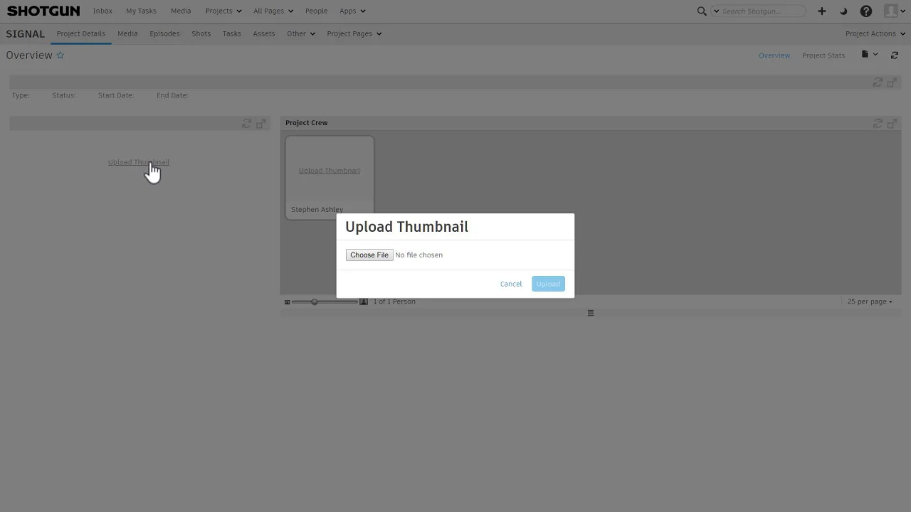

Once we create our project, we’ll land on Project details. All the important things we are tracking are visible in the Project Nav. Let’s add a project thumbnail and fill in a few key details.

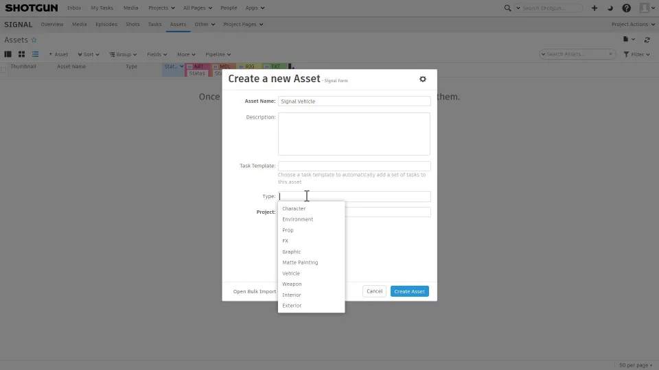

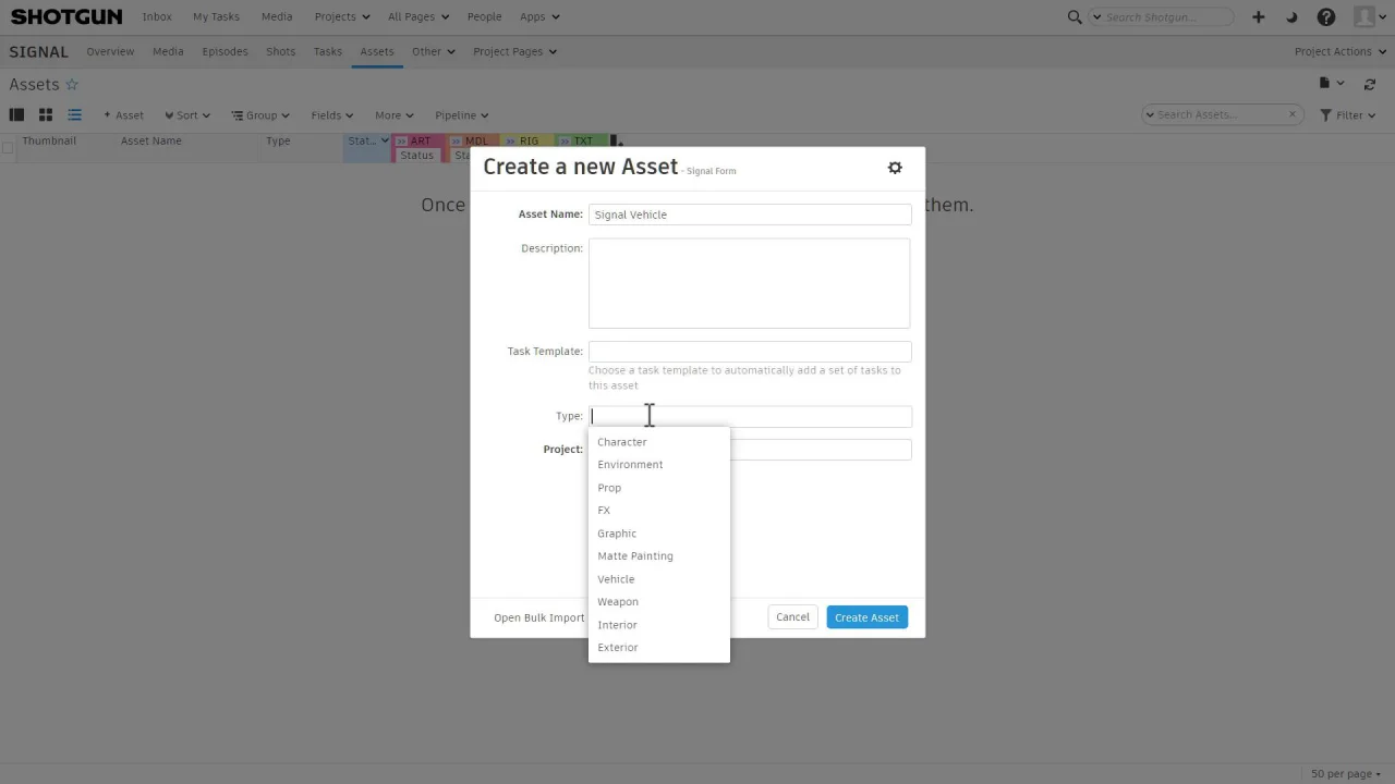

We create Assets from the Assets page. Let’s make the Signal vehicle and the Flats environment. Notice how there is an option for the Task template. Let’s clear the value for now as we’ll explore Task templates next. We can hold the alt key to create an asset and keep the form values to speed up the process.
getting started

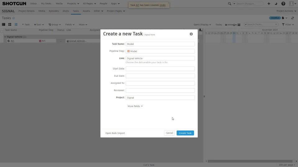

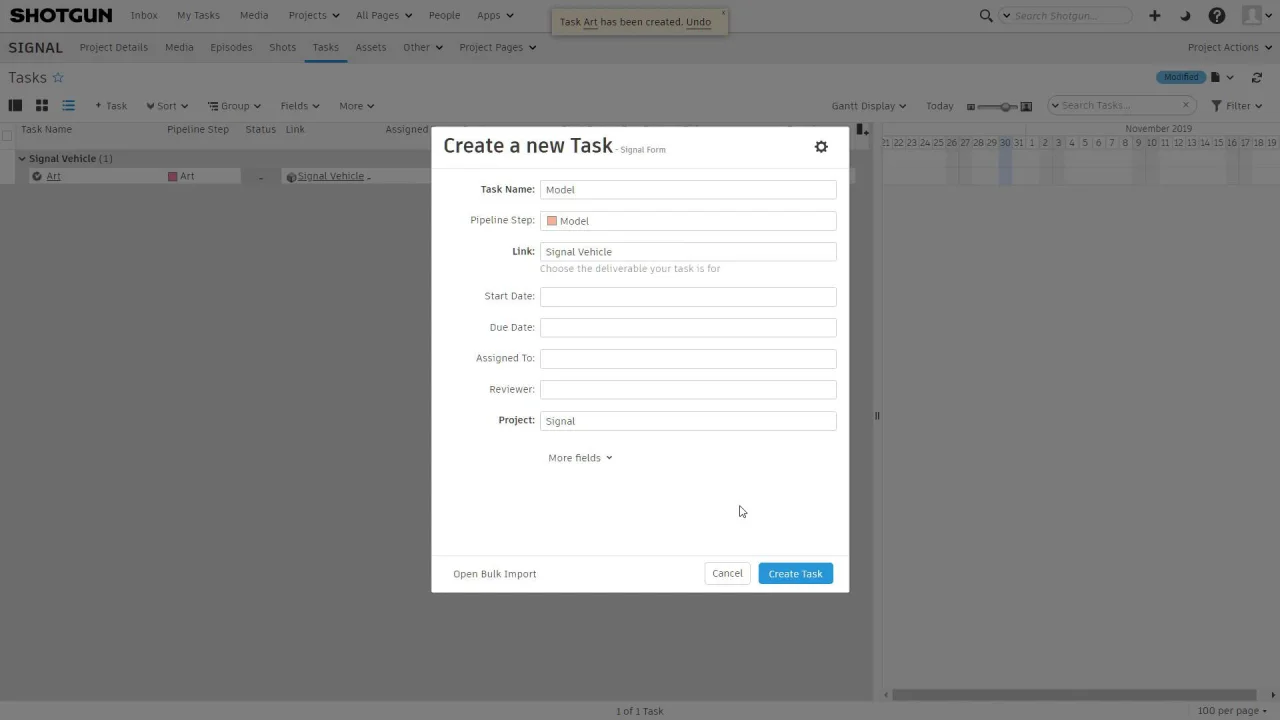

Now that we have these two Assets, let’s create tasks. We can create one-off Tasks, link them up to an Asset, and again hold the option/alt key to keep the form values.
getting started

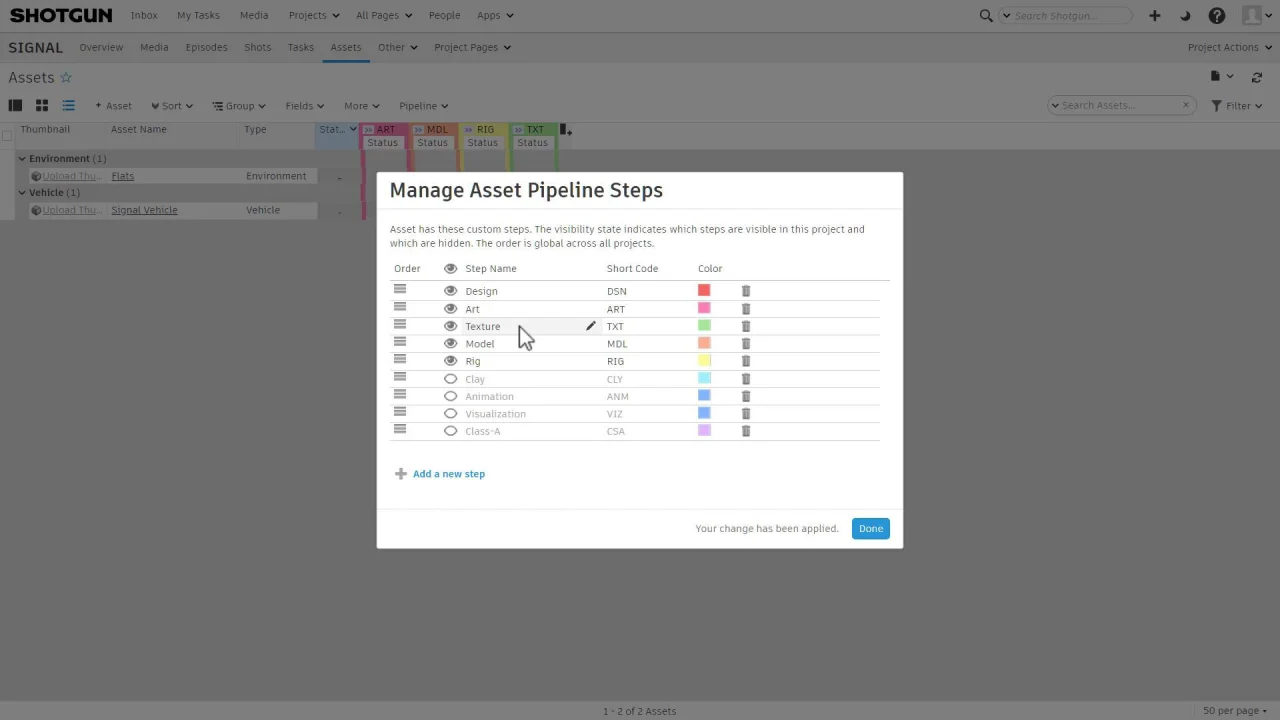

Let’s think about our pipeline, and how things move through different stages of their lifecycle. For Assets, we have four different departments responsible for completing Tasks: Art, Model, Rig, Texture.
Let’s update our workflow in our Project. This also reflects the order Tasks flow through the pipeline, and we have the ability to reorder these.
getting started

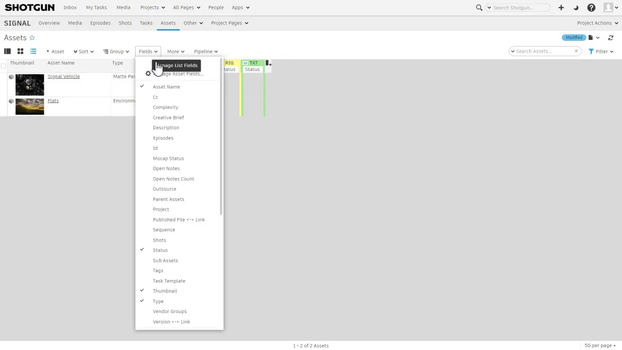

Now, on our Asset page, we just expose the Task Template field via the Fields dropdown, and apply the “Signal VFX Asset” template to our flats asset. And viola, we now have Tasks created on these.
getting started

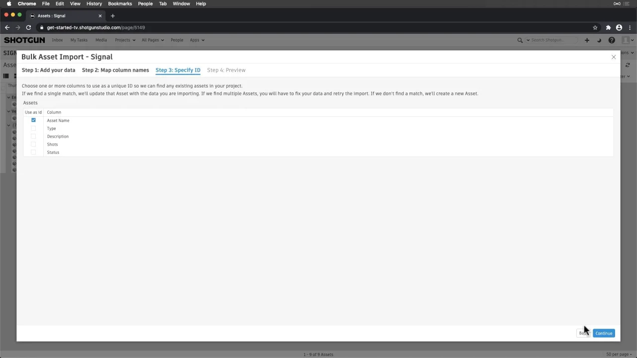

We’ll also create more assets that will be linked to other Shots. We do this from the Assets page via the importer:
  1. Import the Assets breakdown sheet by copying and pasting it into the window
  2. Map the columns.
  3. Use the Asset Name as the identifier for existing assets so those get updated with this additional information.
  4. Add Asset thumbnails to make them more visually appealing.
Note:
importing may take a little while depending on thumbnail image sizes.
getting started

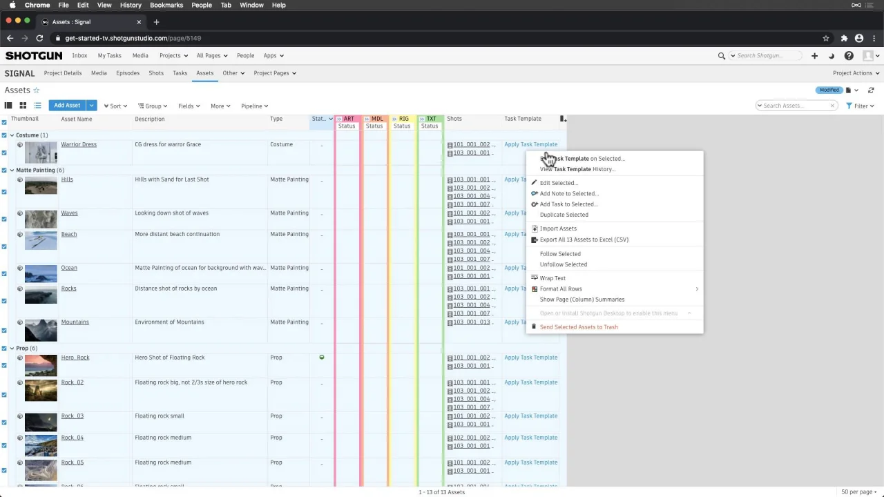

Now that our Assets are looking good, let’s take a moment to apply the standard task template that we created earlier, where the task template is blank. We can use the filter panel to filter for Asset where the Task Templates are blank, then bulk update.
getting started
