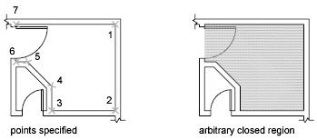

Calculate a Defined Area
You can measure an arbitrary closed region defined by the points you specify. The points must lie on a plane parallel to the XY plane of the current UCS.

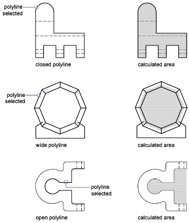

Example: How Various Areas are Calculated

To calculate an area you define
  1. Click Home tab Measure panel Measure drop-down menu Area.
  2. Specify points in a sequence that define the perimeter of the area you want to measure.
    Note: If necessary, click on an object snap.
  3. Press Enter.
    The first and last points connect to form a closed area. The area and perimeter display in the current units format.
