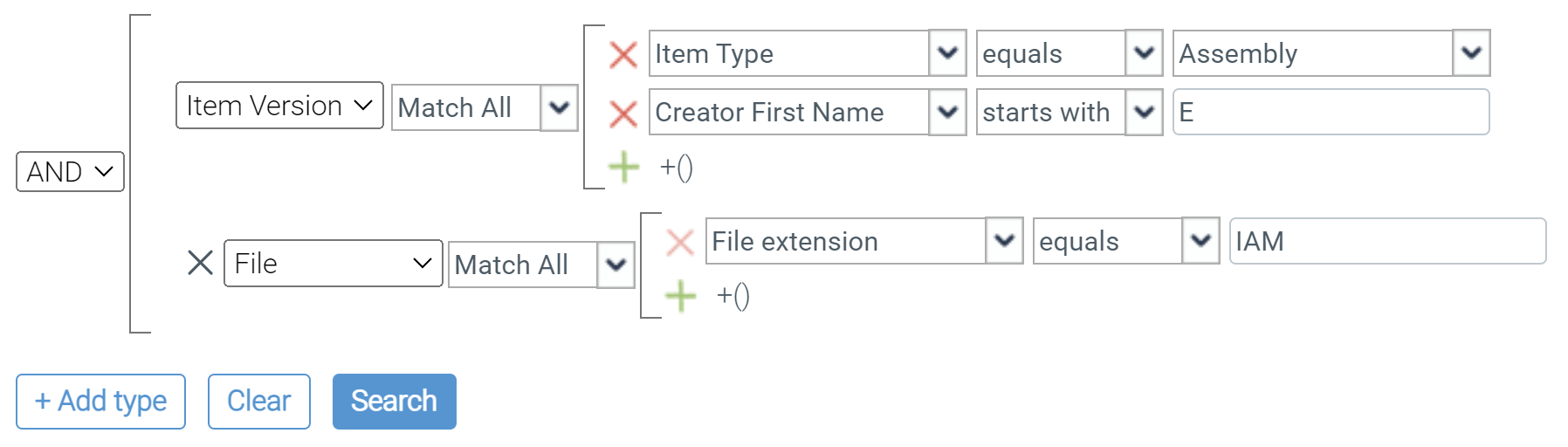

Click Add type to add more criteria to further narrow down your search.
Use the AND operator to search for objects that contain both types.
Use the OR operator to search for object that contain either of the types.
Tip: Here is where it may be useful to add an additional object type (Project, Customer, eBOM, CR, CN) to help narrow down your search for an item or file.
Click Search.
