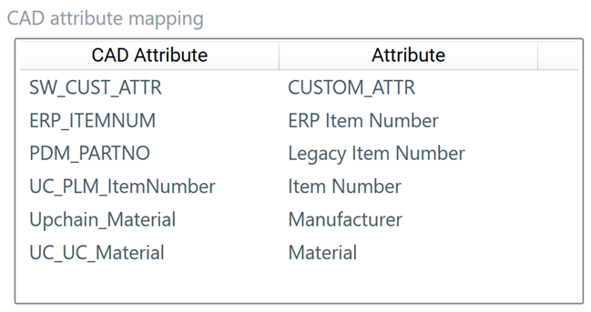

show.attributes.mapping Enables the property mapping window in the CAD plugin settings. This allows you to preview which CAD attributes are mapped to specific item attributes. cad_attributes_mapping.png All supported CAD plugins
