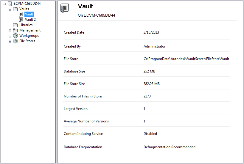

View the details for a specific vault.
  • In the ADMS Console navigation pane, select a vault from the Vaults folder.
A summary of the selected vault is displayed. The statistics include the:
  • date the vault was created
  • name of the account that created the vault
  • location of the file store
  • number of files in the file store
  • total amount of space used by the vault database
  • amount of space used by the file store
  • largest number of versions of any one file
  • average number of versions across all the files in the vault
  • whether or not database defragmentation is recommended
