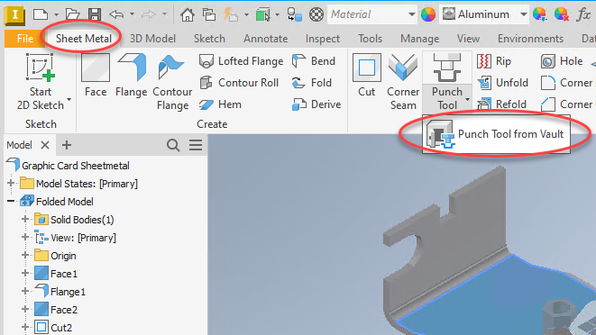

A new "Punch Tool from Vault" command is added to the Sheet Metal tab in Inventor. It enables you to browse for a 3D iFeature shape from the Vault to be inserted into the sheet metal face.
Sheet Metal Punch tools are iFeatures with extra attributes that cut simple or complex hole shapes in the face of your part, including across a bend. You must have a 2D sketch with at least one hole center point before using the Punch Tool from Vault command.
For more information, see Insert Punch Tool from Vault.
