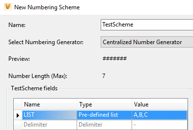

Consider you have the following numbering scheme called TestScheme.
Now you want to pre-pend the filename with a fixed text based on the selected document type:
ENG-
for Inventor assemblies and parts (e.g., ENG-A-00004.ipt)ENGDOC-
for AutoCAD/Inventor drawings and Inventor presentations (e.g., ENGDOC-B-00001.idw).OFF-
for all other files (e.g., OFF-C-00002.docx).
