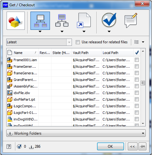

  • Full GUI
    An interactive GUI appears that allows users to modify the options (gathering-options,-which-files-to-check-out,-comments,-download-location,-etc.). This GUI allows files to be viewed in a List View, Folder View, or Design View. All of the views support configurable columns which include support for thumbnails.

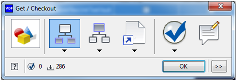

    The Download/Check out dialog has a collapsed and expanded display.
    Collapsed
    Expanded

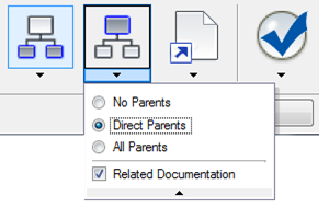

Relationship Gathering
When downloading or checking out a file, you can specify whether any related files are also downloaded or checked out. The VDF supports relationships for including child relationships, parent relationships, or files brought in through links.
  • Include Child Relationships
  • Include Parent Relationships
  • Include Linked Entities

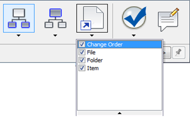

Multiple Entity Download
The VDF not only supports file and folder downloads, it also supports entities such as items, change orders, or custom objects. The VDF interrogates these entities and selects the primary files associated with them for download.
