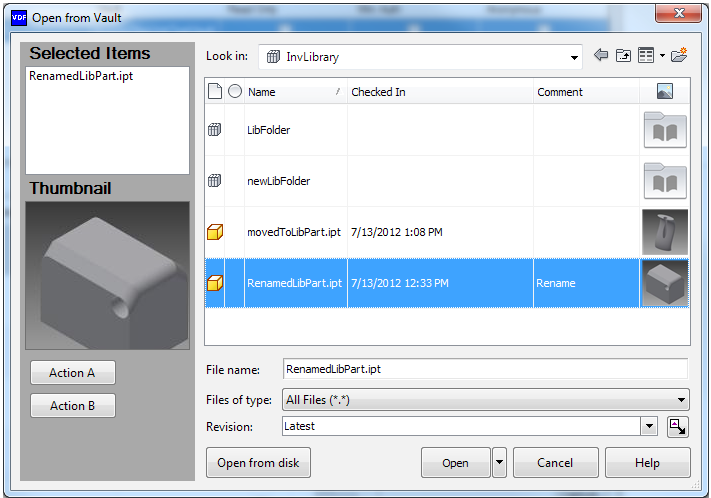

  • Dialog Caption
    For example, in the dialog image, the Dialog Caption is configured as "Open from Vault."
  • Selection Label
    For example, in the dialog image, the Selection Label is configured as "File name."
  • Initial Selection
    The initial value of the text box next to the Selection Label.
  • Selection Filter Label
    For example, in the dialog image, the Selection Filter Label is configured as "Files of Type."
  • Action Button Text
    For example, in the dialog image, the Action Button text is configured as "Open."

The filters (e.g., Files of Type in the dialog image) can be configured. Filters based on file type, regular expression, or any other custom algorithm can be added to the combobox.
