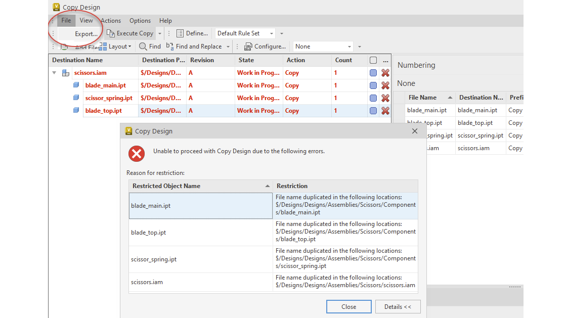

Export File List
During a copy operation, if there are any files with restrictions, a warning dialog displays a list of restricted files highlighted in red. You can export the restricted file list to an external file (xls, xlsx, txt, htm, html) for reference.
Use the Export functionality to export the restricted files highlighted during the copy operation.
For more information, see Copy Design - Walkthrough.
