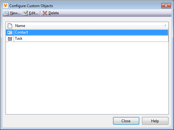

Access the Configure Custom Objects Dialog Box
Create, edit, and delete custom object definitions.
Note: You must be an administrator to create or modify custom object definitions.
Access
Click Tools > Administration > Vault Settings.
In the Vault Settings dialog box, select the Custom Objects tab.
Click Configure to open the Configure Custom Objects dialog box.
