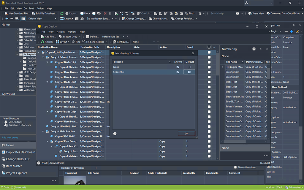

Copy Design – Numbering Scheme
Eliminate Renaming Headaches with Default Numbering Distribution
Vault 2026.1 streamlines the Copy Design process by enabling administrators to establish and disseminate a default numbering scheme for all users. This improvement guarantees consistency from the outset, thus averting expensive renaming tasks and diminishing errors that may arise from improper numbering or naming conventions. By standardizing the nomenclature of new designs, teams conserve time, remain aligned with corporate standards, and ensure that projects progress without disruption.
For more information, see Copy Design - Select Numbering Scheme

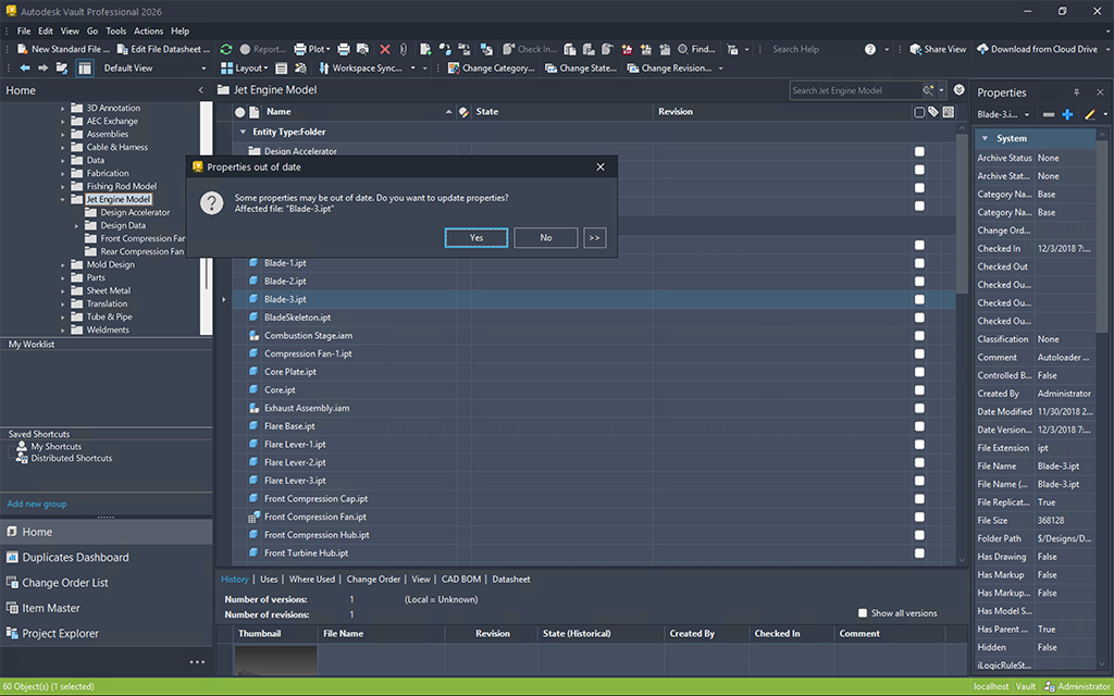

Update Properties Enhancement
Vault 2026.1 eliminates the inconvenience associated with manual property updates through the introduction of a new, intelligent prompt during file check-out from the Vault client. When users initiate the check-out of a file within the Vault client, they are promptly reminded to update the mapped properties, thereby ensuring data synchronization without necessitating additional steps. This straightforward automation mitigates errors, conserves time, and maintains alignment between designs and Vault data. Though it represents a minor alteration, it possesses a substantial effect on overall productivity.
Feature was inspired by suggestions from the Vault Community Idea Board.

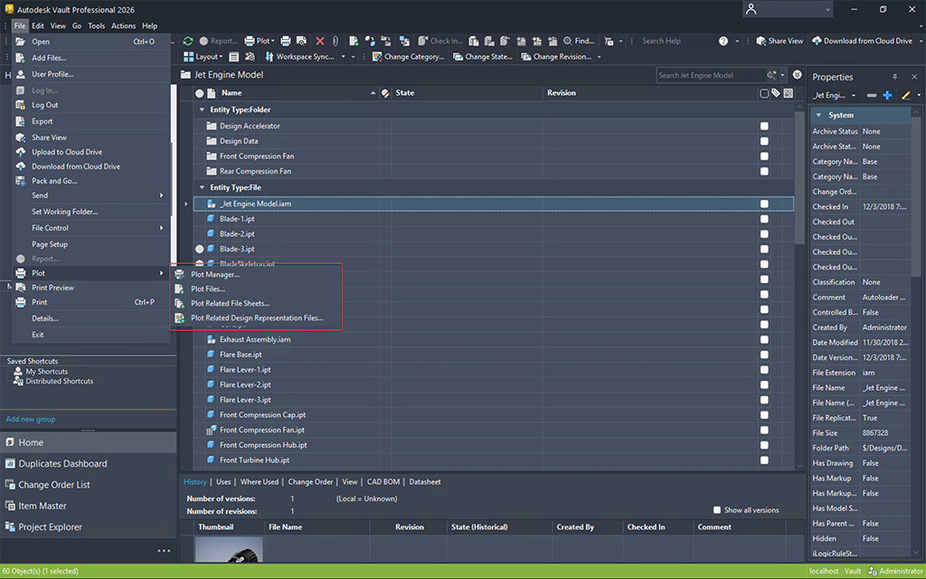

Batch Plot Enhancement
Batch Plot Smarter - From 40 Clicks to Just 3
Vault 2026.1 brings a revolutionary advancement to batch plotting through a markedly simplified workflow. Instead of navigating through a cumbersome process involving 40 manual clicks, users are now able to generate comprehensive drawing lists in merely three clicks by utilizing the new “Plot Related Design Representation Files” command. By selecting the top-level assembly, Vault systematically compiles all pertinent design representation files, which are then prepared for batch plotting. This enhancement not only saves time but also diminishes errors, thereby allowing your teams to concentrate on design rather than file preparation.
For more information, see Access the Plot Manager

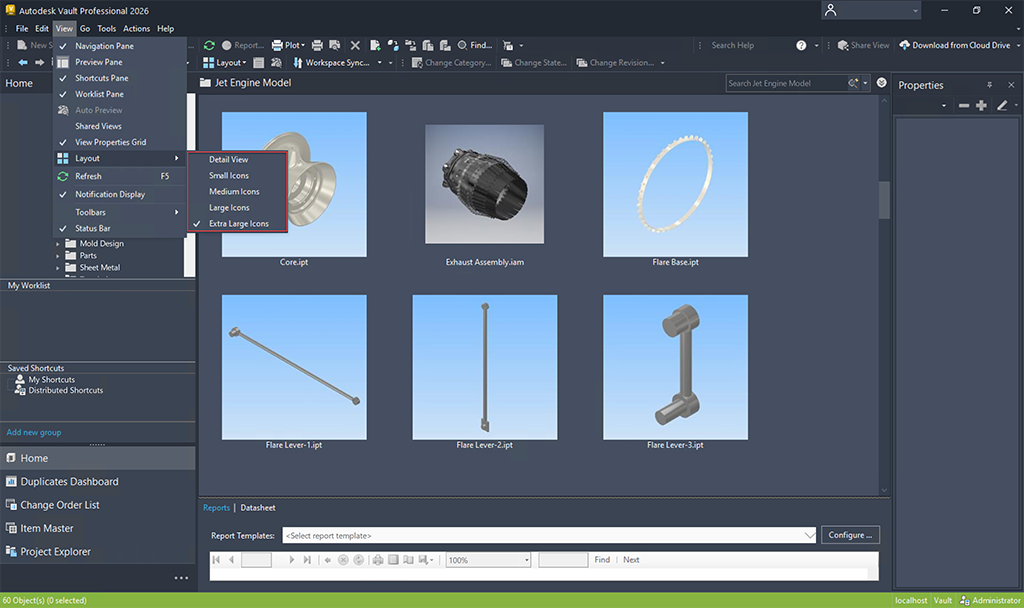

Layout View Enhancement
Bigger Thumbnails, Faster Decisions
Vault 2026.1 enhances the viewing experience by introducing resizable thumbnails in the Vault grid, allowing for easier differentiation between similar models and drawings at a glance. Users are no longer required to open files individually to locate the correct one. This update substantially decreases the number of clicks necessary, streamlining workflow processes and increasing productivity. With improved visuals and reduced procedural steps, users will spend less time searching and more time focused on delivering results.
